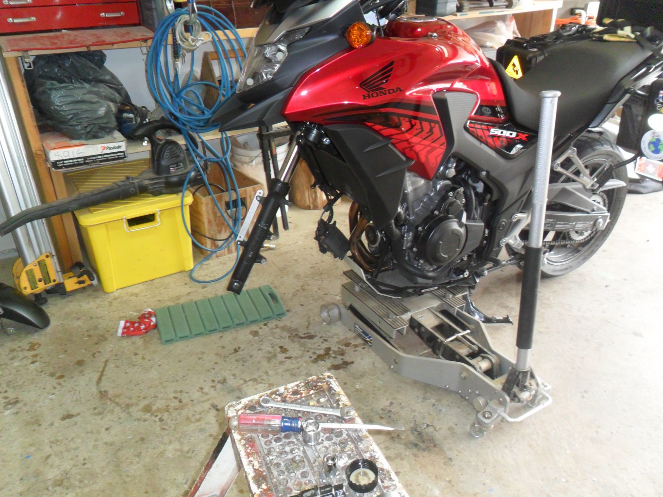

After a couple month wait for the arrival of my Ricor Intiminators Inertia Active Valves , I finally received them and installed them this past weekend. Jon at Ricor was a pleasure to deal with, he sent a second shipment after the first shipment was stuck in LA for over 5 weeks seemingly lost. The first shipment did finally show up after 3 months in transit!
I had the Ricor valves in my F650GS for over 100,000km and they transformed that bike so I look forward to trying them in the CB500X. Once I have ridden a few trips I’ll report back. For now this is just the installation report.

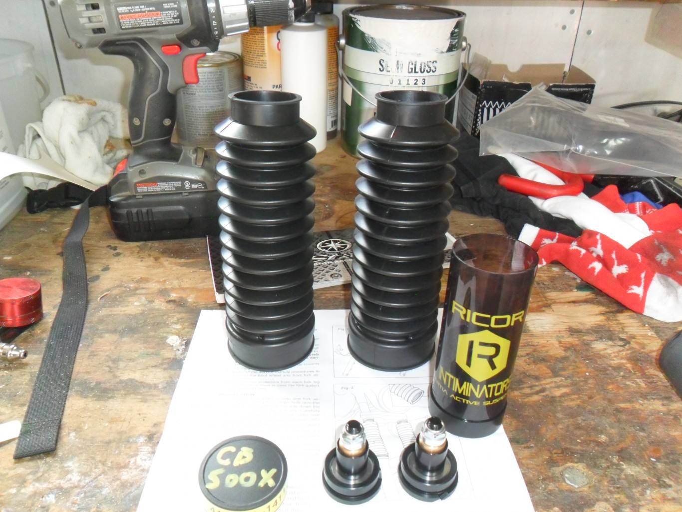

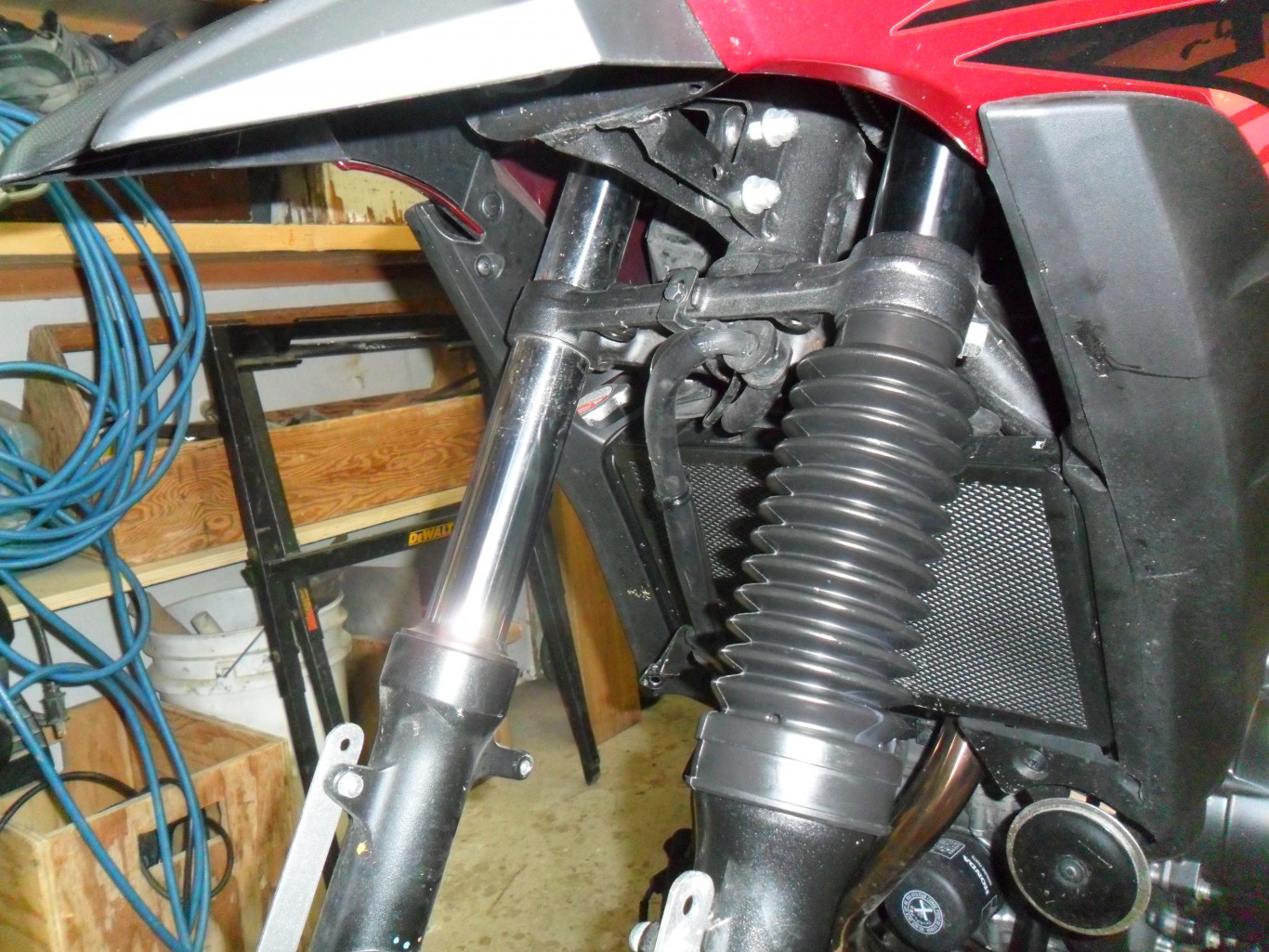

I also bought the Yamaha Bolt 2014 /2017 fork Gaiters to install since the forks would be off, they fit perfectly. Part number 1TP-F31E0-V0-00

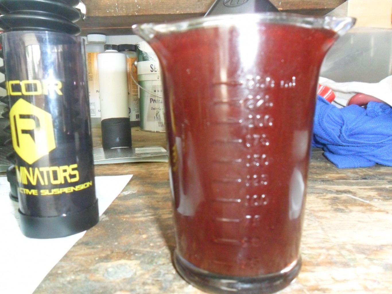

The Honda workshop manual states that the 2018 forks contain 434 ml of 10 wt oil. I measured the oil I drained out at 400 ml the same in both forks, some may have been on the springs hence the lessor amount?
The Ricor valves drop into the tubes with just a small amount of friction and slowly fall down to rest on the fork piston. Jon sent me various size wear rings ( like a piston ring) so I would have a friction fit inside the tubes. I measured the ones I used at 36mm. The valves are meant to fit a Transalp and the wear rings were a little small so I used the next size up. There was no listing for the CB500X. The part number is 41D-50-1411.

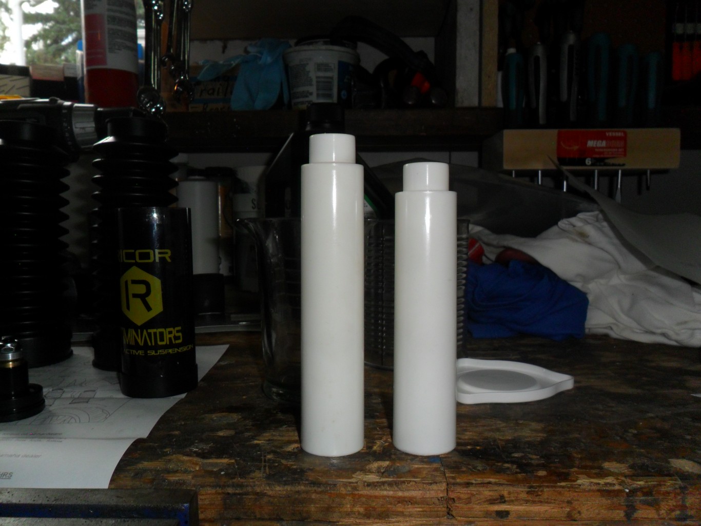

I then cut the spacers by 5/8th “because that was the width of the Intiminators.
