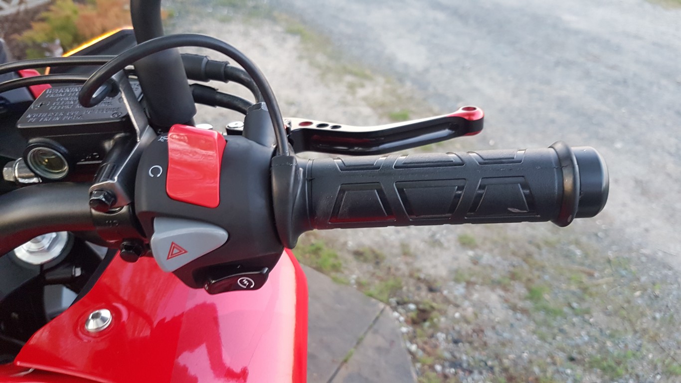

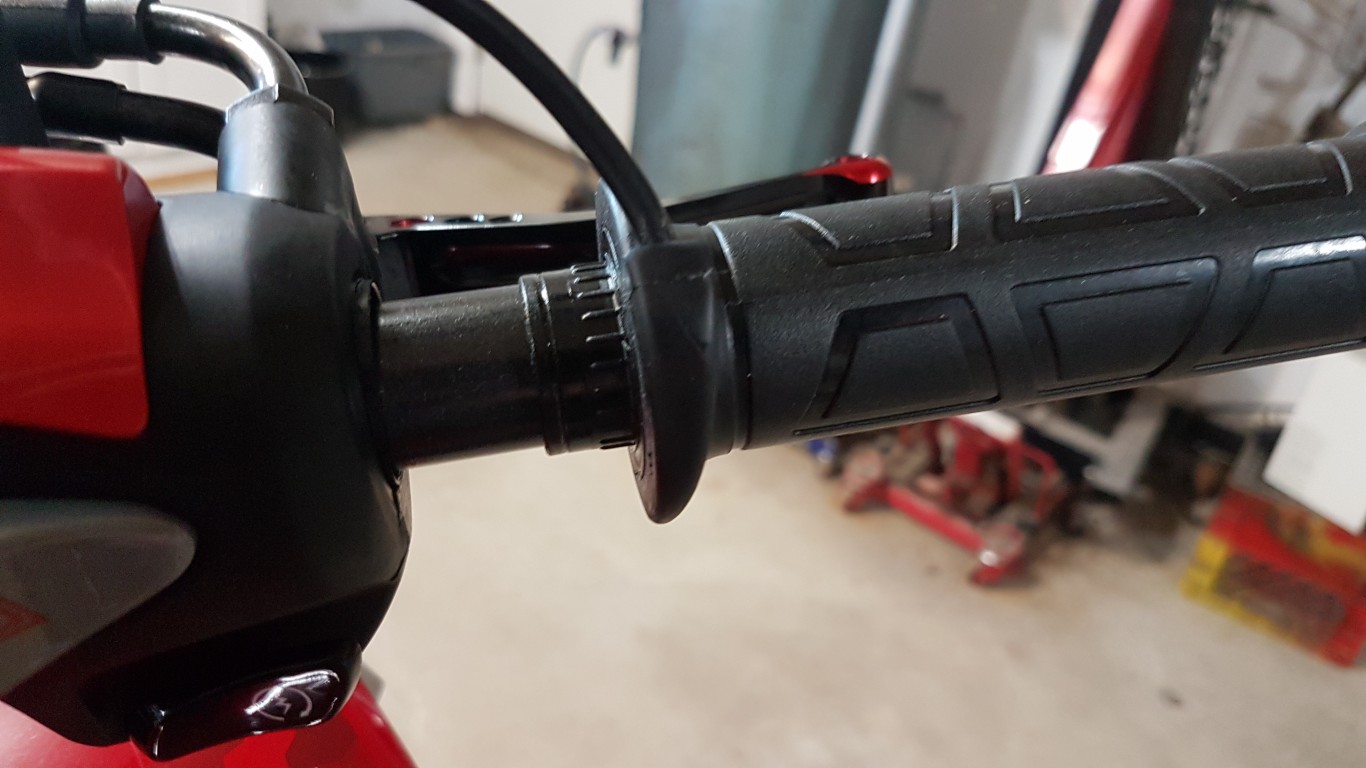

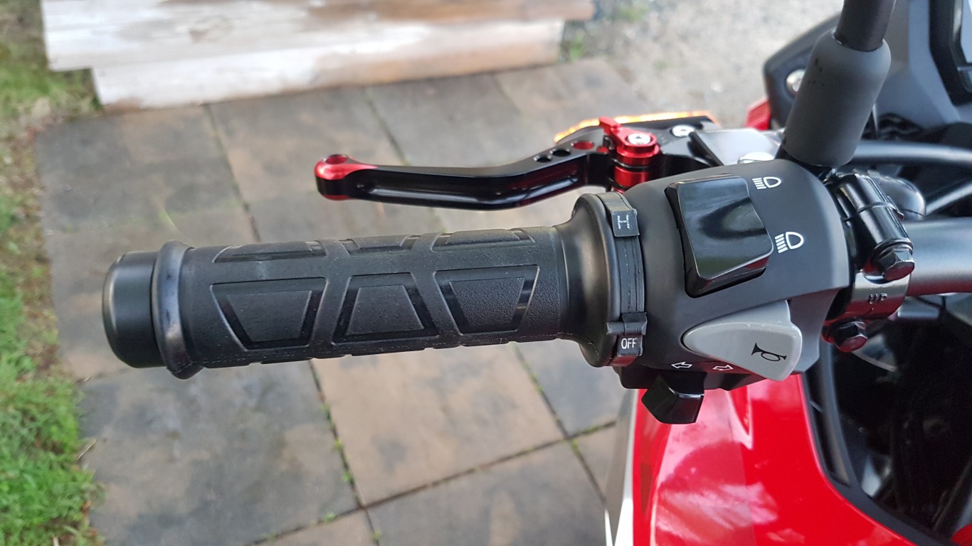

Sorry but forgot to mention that the throttle tube grip has to be indexed so the the wires point in the preferred direction.  After you do this you should assemble using some epoxy to keep it from separating.  After I did this, it's been perfect.
In this photo the grip is not indexed correctly.  The wire should be point down so it's out of the way.
The left side just has to be slid on either the wire facing down.  Nothing to index and this is the correct position.
