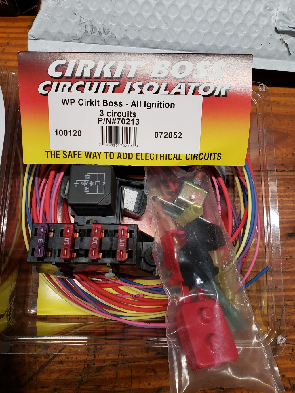

So for my first project I added some grip heaters, and the factory accessory plug.  For my 12vdc power needs, I also added a Painless 3 circuit / ignition switched fuse block.  I figured I would need more power for additional accessories.  I used one circuit to power my new heaters, and now have 2 spare unused circuits under my seat just waiting for the next project.   :002:
Here's the fuse block I got from Painless Wiring.  It's three circuits switched with the key.  Each circuit is rated for 10 amps.  I mounted the fuse block on the right side under the faring, and it fit just perfect.  I had to bend a little metal to make a bracket to hold the fuse block, but was a pretty easy job.

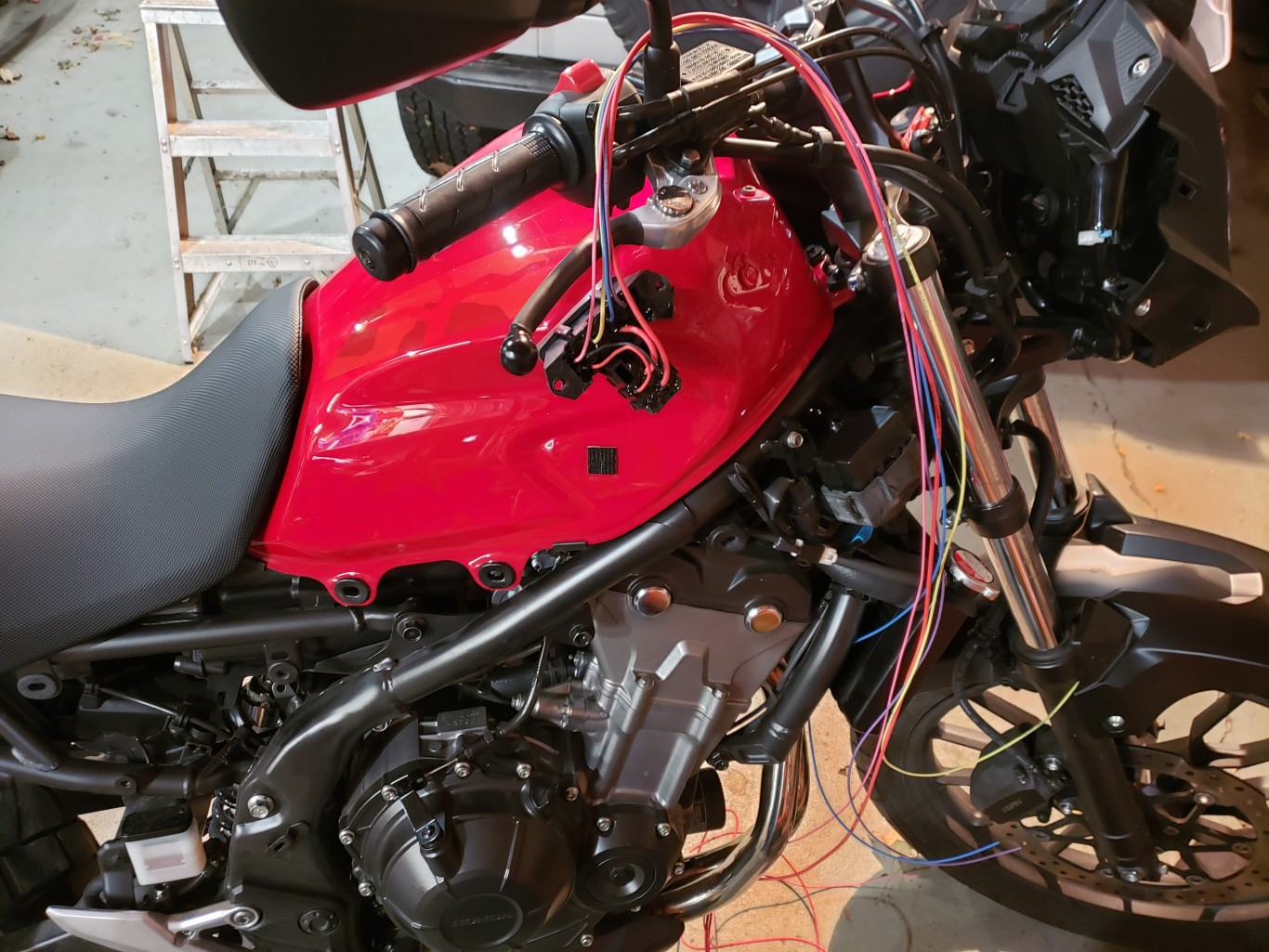

Here's the location I picked out.
I used the existing bolt and added a small bracket I made and attached it to the bike.

I cut the Oxford factory power harness and wired it to my first new circuit, fused at 5 amps.  Ran the 2 spare circuits, 12 gage power wire, and coil wire inside wire mold along the right side to the battery / seat area.  I used the factory plug under the seat to fire the new coil for the fuse block.  Wired the 12 gage fuse block power to the battery using a inline fuse, and coiled up the 2 spare circuit wires.  For future projects, all I will have to do is install a fuse in the spare circuit and find a ground.   I'm thinking a heated jacket, and maybe some pants.   :002:
All wired up.
