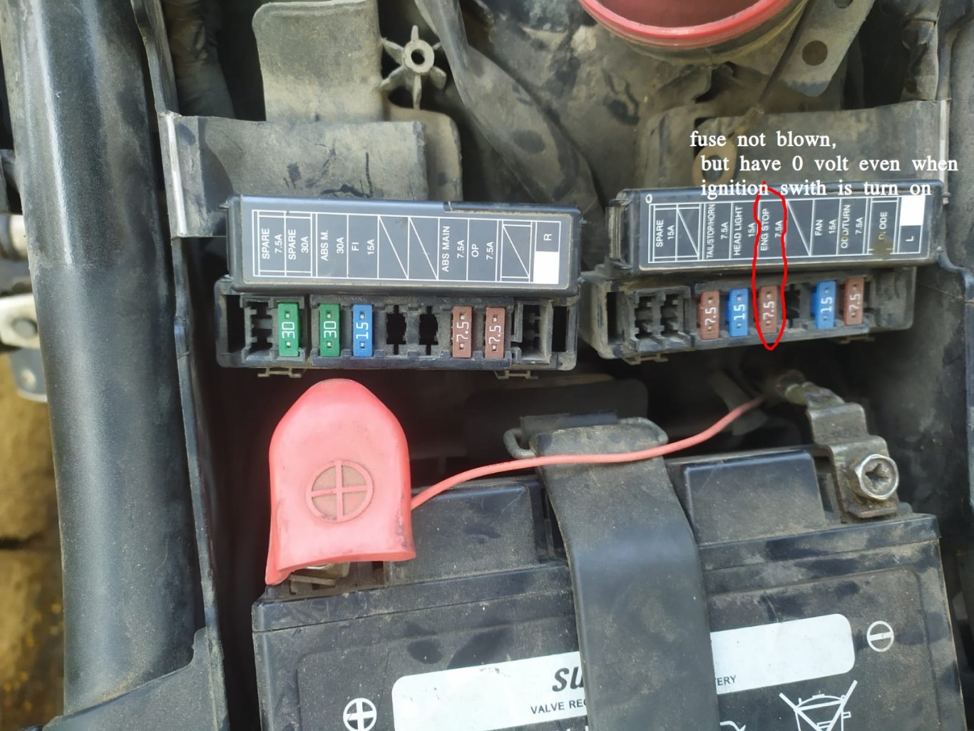

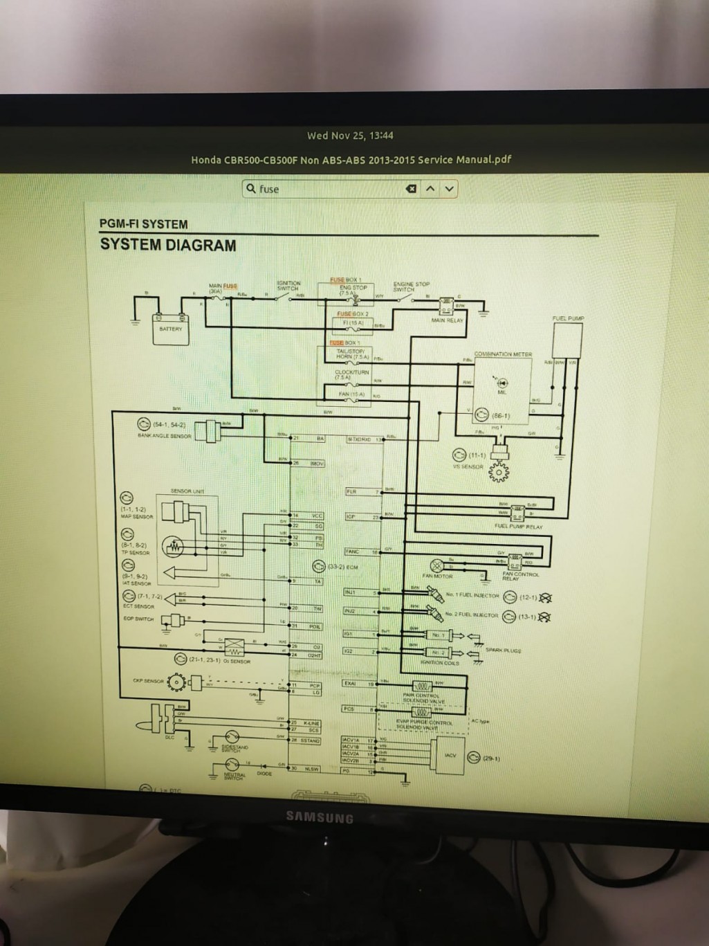

I recently had a problem with the ignition switch, when I turn the key, it doesn't react at all. no light (nor from the meter nor from the headlight) and no sound.
I checked the battery voltage (~12v) and I checked that all the fuses are ok, include the main fuse.
I see no difference in the voltage of the fuses when I change the switch status.
I am suspecting that the switch mechanism is damaged, but I can't tell for sure.
Does anyone have any advice?

You may need to check the relays and fuses under the right cowl, also.

I already checked the main fuse and it's ok,
How can I check the relay over there?
