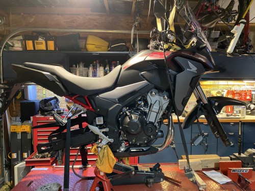

Hello all!  Super excited just took delivery of my 2021 X and I am preparing my order for the level 2 suspension kit order... I live in Colorado and ride off road as often as possible.  I am 205 lbs and will ride this bike as aggressively as it will let me  :002: I do carry tusk highland soft luggage for the weekend camping rides and BDR's.  I am just hoping to hear some feedback from similar riders before I place the order.  I literally pushed it off the delivery truck from the dealer and up on to the lift and removed the wheels..... I am so ready.  thanks everyone in advance.  I would also love to hear from Jenny on this subject  :763:
