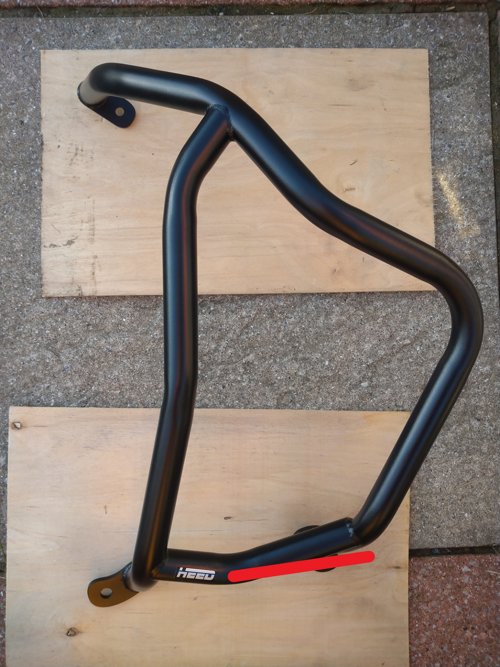

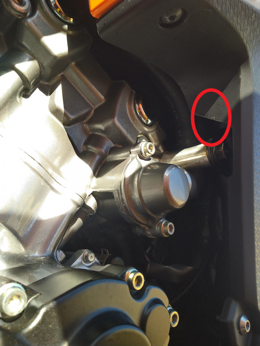

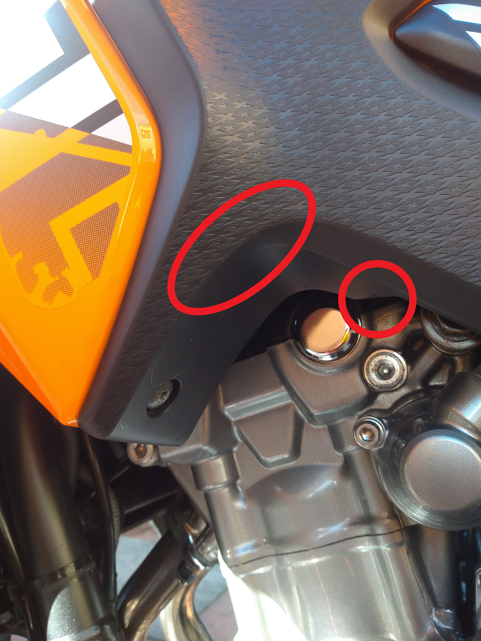

the bars contacts where the big circle is and the mounting tab contacts where the small circle is.
mounting tab contact patch from underneath, if it was only this i could trim the plastic to clear.
not a very good explanation if the heed sticker bar was straighter and the right side lower bend was lower it would probably clear the panel.
the crash bars and bracket weighs 3.85kg.   (i did not weigh the bolts that came with it as they replace the oe ones so seemed pointless)
the side panel on the 2017 is deeper than the 2013/15 even though it looks narrower because of the coloured infill panel,
i will try and space the crash bars out 5mm or 10mm to clear plastics on another day when the sun is out if i cant get them to clear they will be up for sale.
 I would definitely buy another set of heed bars for my bikes very impressed by the quality of the workmanship and the packaging they came in, instructions were clear enough once you read through them once or twice

if i were to space the bars out i would have to space the all the mounting points out as well to keep it square.
i didnt get the lower bars as im intending on getting a rr engine guard at a later date.
never had any experience with sliders or crash bungs, though i have seen the good and the bad they can do in the event of a crash depending on they are attached.
i was looking at hepco & becker tank bars and these heed ones, just didnt know which i would receive.
there is two ways to get these crash bars to fit one is alot of work with cutting and welding new tubing in or two is just go and buy 2013 side panels as they are a direct swap.
i remembered jmo heritage build and went looking for it and she fitted later panels to earlier model
https://www.cb500x.com/index.php/topic,4511.msg43716.html#msg43716
and in this one she puts earlier panel on a later model
https://www.cb500x.com/index.php/topic,3864.msg37349.html#msg37349
