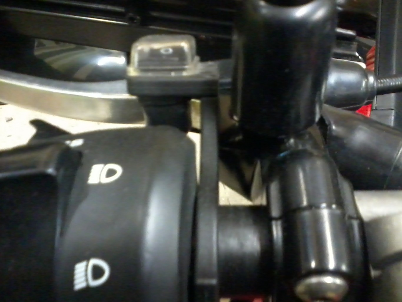

Aux light switch and bracket....for when i can afford some aux lights
Plus a nos clutch lever cover from a Superdream. Fits like a.....clutch lever cover. should be standard on the X imo.
The switch can be bought from most places (I like Durite stuff) but the mounting bracket is the thing...I didn't want a bulky switch and wanted to be able to operate the aux lights (eventually) without taking my hands from the bars. It's available from Dynojet, listed as a 'map selection switch bracket'...the price? All of 4 something...it's a gem where bar space is at a premium
I used the boot of an old school suppressor cap as a shroud to cover the back of the switch and terminals
