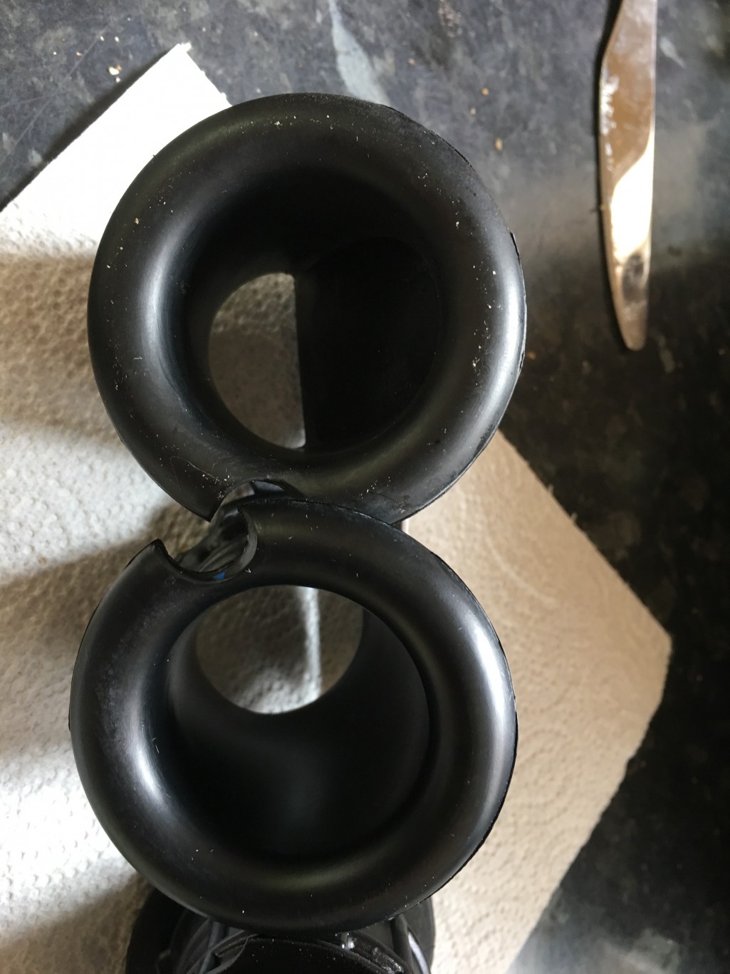

If you have a UK/ Euro spec CB500 (any variant), the velocity stacks (tubes inside the airbox) have an inbuilt restriction, as an easy way to ensure A2 licence compliance.
Go to Partzilla.com and order;
17251-MGZ-A00 FUNNEL, L. AIR (Honda) $7.57
17252-MGZ-A00 FUNNEL, R. AIR (Honda) $7.57
It's another $15 for delivery and takes about 10 days.

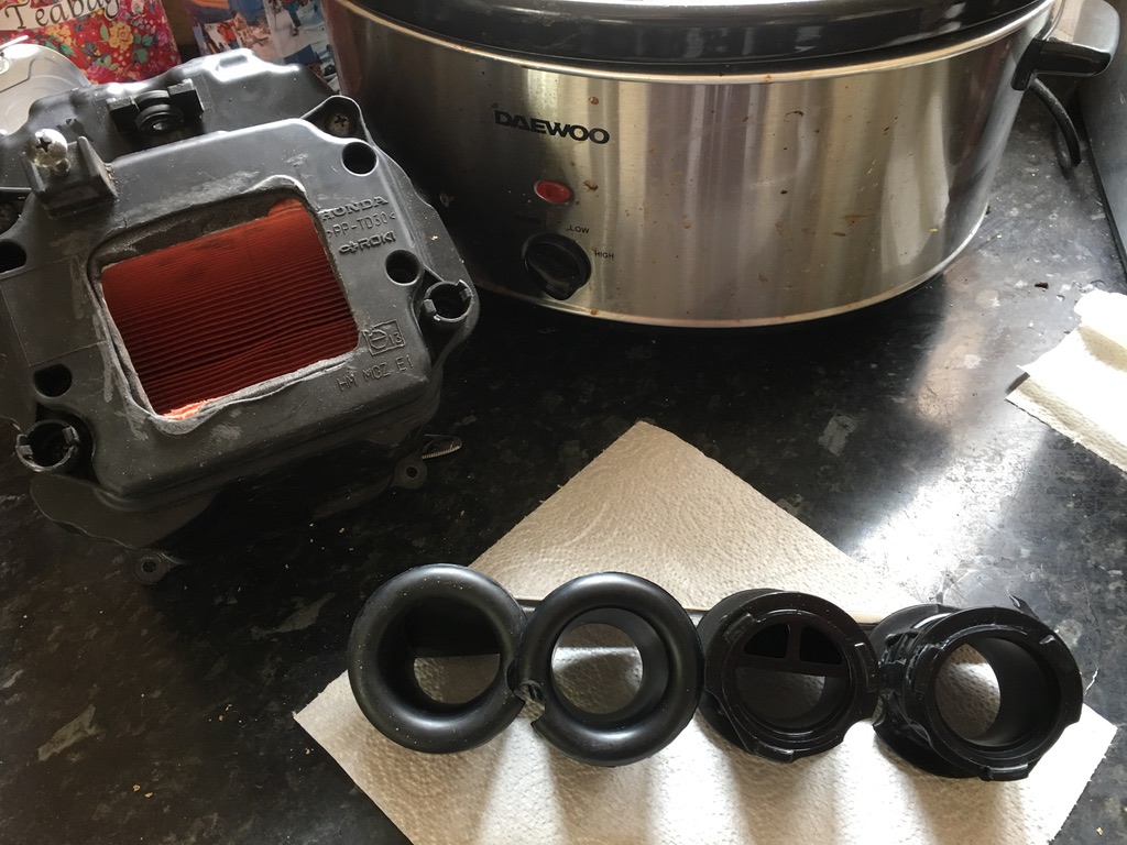

Whilst I was in there, I binned the snorkle and opened up the air filter cover, so that the air can get through.  Keep enough of the cover that it can seal against the foam part of the air filter.
You can either trim back the air filter plate (as I did), or go to racingairfilters.eu and buy a foam filter which already has the plate opened up.
Change the velocity stacks over and put it all back together.
On the road, it has a slightly stronger midrange, revs out easier and has a nice intake growl.  Bum dyno only, as we're cheapskates, so no lovely before and after figures- sorry :( Son's bike has a Scorpion silencer, so it's all nice and throaty :)
So, there we have it.  Wait until the air filter needs changing (or valves need doing), order up the bits a few weeks before and say hello to easy power.

It's possible John.  It's what I would have done, had the OEM option not existed.  It would be quite fiddly to do a neat job though.  Not worth the hassle for £25.  It's not just like tapping a washer out of our 125s  exhaust :002:
Check out the photo that looks like a smiley face; you'd have to cut out the sides without cutting through the 'main tube'.  If you want the FOC option though, you could do that.

Are the new ones completely open ? I.e no restrictions at all ?
If so then I can see a job in my future.. could even stick it in the lathe to ensure a neat job  :001:
John
Currently living in an old farts body
Offline Blakes7
  • Posts: 20
Re: Cheap Airbox Mod
Reply #8 on: July 18, 2019, 02:45:16 PM
*Originally Posted by Jaws [+]
It wasn't a newer one, it's an American part, which is different to the one we get in the UK.  It's a different part number, for a different market.  Not sure a slightly curved rubber tube is the most lathe friendly medium.  A nice shiny aluminium one could work though...
