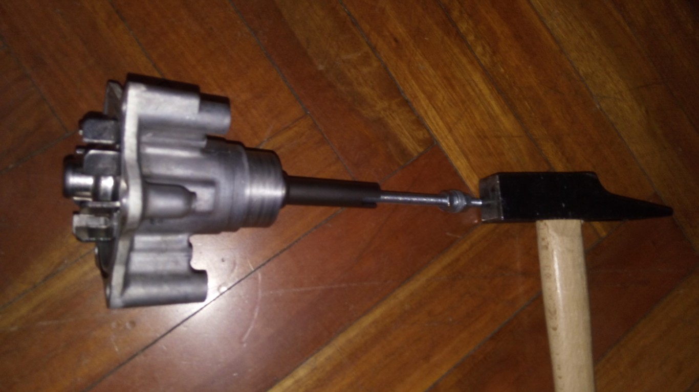

- The pump can be disassembled without damage. First of all - remove the pump cover. When you removed the cover you will see the impeller. To access to the seals you should remove the impeller. To remove the impeller you need 6-7mm diameter and 160 mm long steel rod or similar. Introduce the rod in a hollow pump shaft. You need to hammer it gently - the rod will pushing the impeller out of the shaft. In my case case 4 hammer fists was enough to remove it.

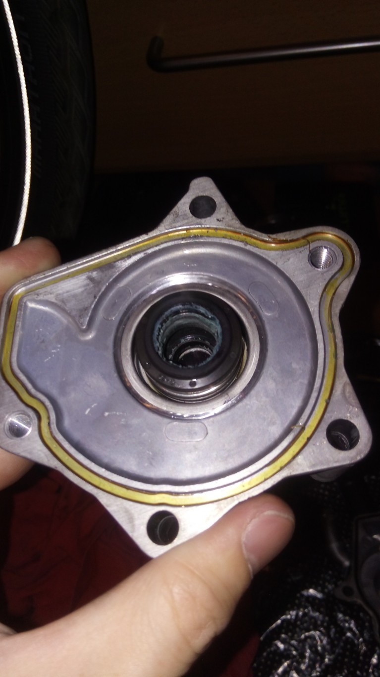

- With the impeler removed you can continue with the seals. This step doesn't requiere any special tool - the only rule is not to damage the pump body or seal mounting surfaces machined in the pump body.

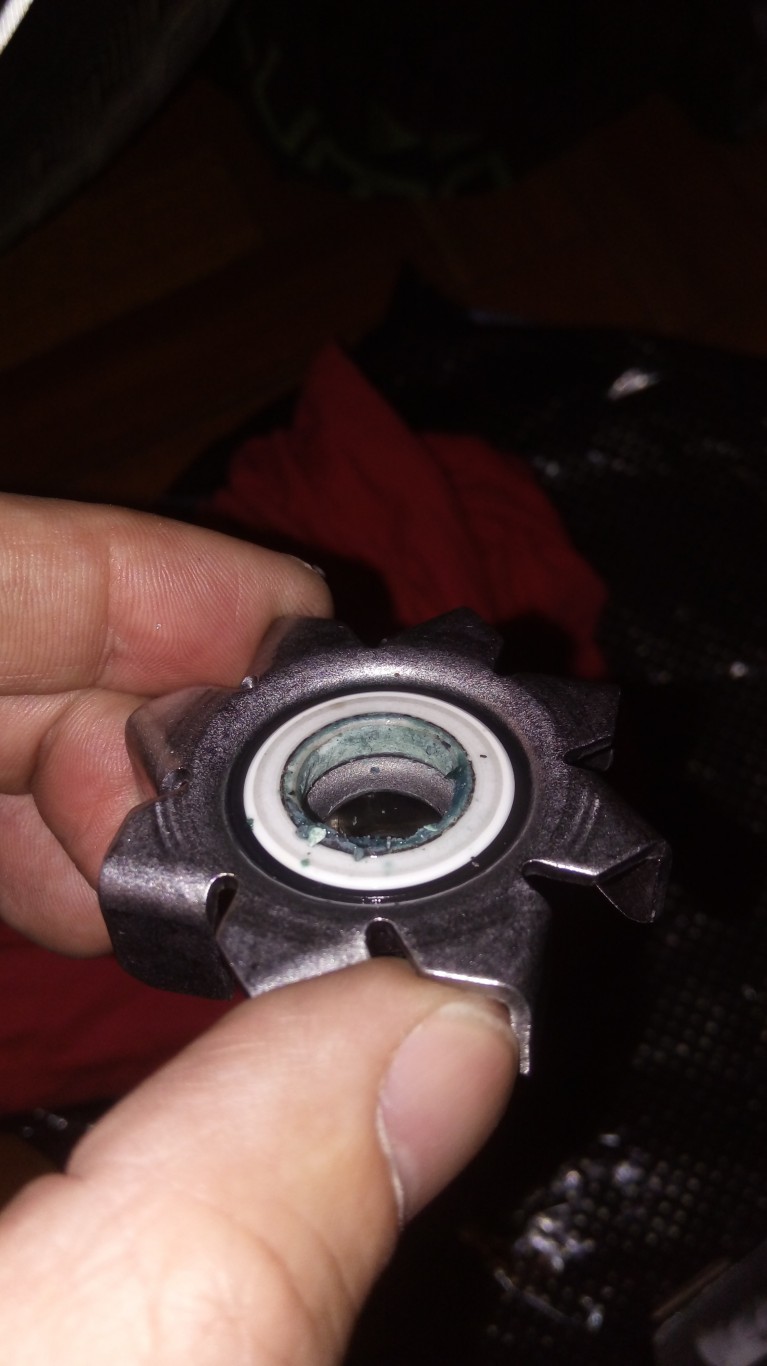

A lot of antifreeze incrustations can be seen on the water seal - an indicator of the problem.
- So you disassembled the pump without breaking it and without hammering you fingers - congratulations  :046:
- Now - with any siutable tool you need to round a bit the chamfer for the oil seal mounting inside pump body. I mean - in its original state the chamfer has very sharp edges and if you try to insert the oil seal the seal will be damaged (don't ask me how I know it XDD). And be extremely carefull to don't scratch the polished surface where the seal is inserted - it might leaks if the surface is scratched.
- The next step is to clean it with hot water and soap - my pump has a lot of aluminium chips inside it due to the defective cleaning of the engine during manufacturing process. I think this was a real reason for the seal leak - aluminium chips in antifreeze.

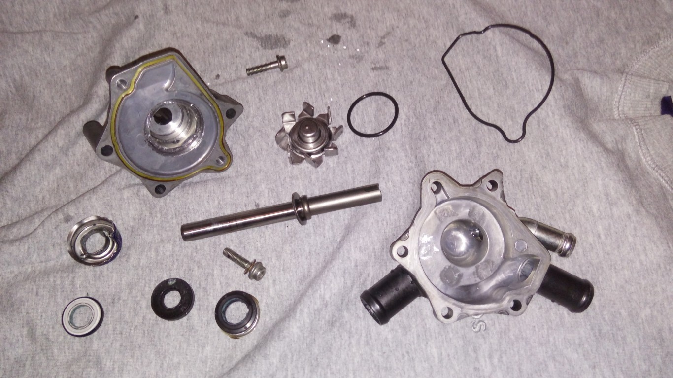

- Once you cleaned everything it's time to mount new seals. The seals you need for the pump are the next one - 19217-MAL-300 for the ceramic water seal and 91201-MV4-003 for the oil seal (any 12 26 7 double leap seal should works fine here).
- Before mounting oil seal you need to prepare your mounting tool. I bought 8mm diameter threaded rod and a pair of 20mm washer and 8mm nuts - as you can see is a sort of seal driver. It will helps you to mount the seals without damaging it. Use a proper nut socket as adaptor to the seal diameter.
- Put a little amount of mineral oil over the mounting surface of the oil seal and introduce it in the pump body with a tool (or a precise hammer fists)
- Introduce the water seal with the tool - in this case the tool is very important - water seal has steel casing so a minor misaligment can damage it. This is the reason why a tool is recomendable - it will avoid the possible misalignment during the installation (you can do it with a vice too). Use a proper nut socket.
- Remove the old ceramic seal inside the impeller. Clean the seal mounting surface with a fine sandpaper. Wash it with hot water and soap and install new ceramic seal.
