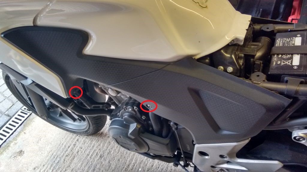

Remove 2x 5mm allen bolts:
and pull panel out of rubber grommits, starting at the rear, to release:

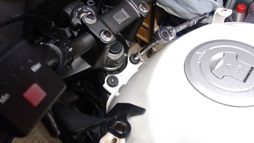

Remove inner fairing panel by pushing in the centre of the plastic clip, using a small allen key, or similar,
and removing allen bolt (5mm) from top of tank

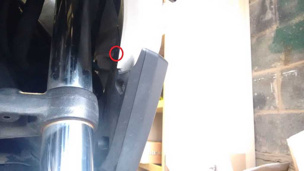

Remove remaining 5mm allen bolts holding panel and plastic Phillips screw clip (also see second photo). First photo shows bolt locations once panel is removed:

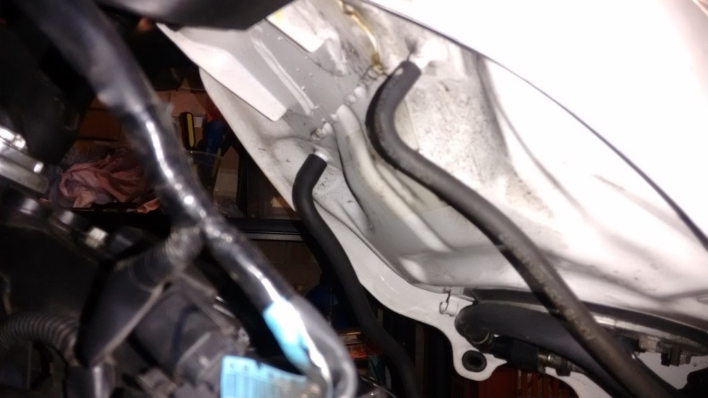

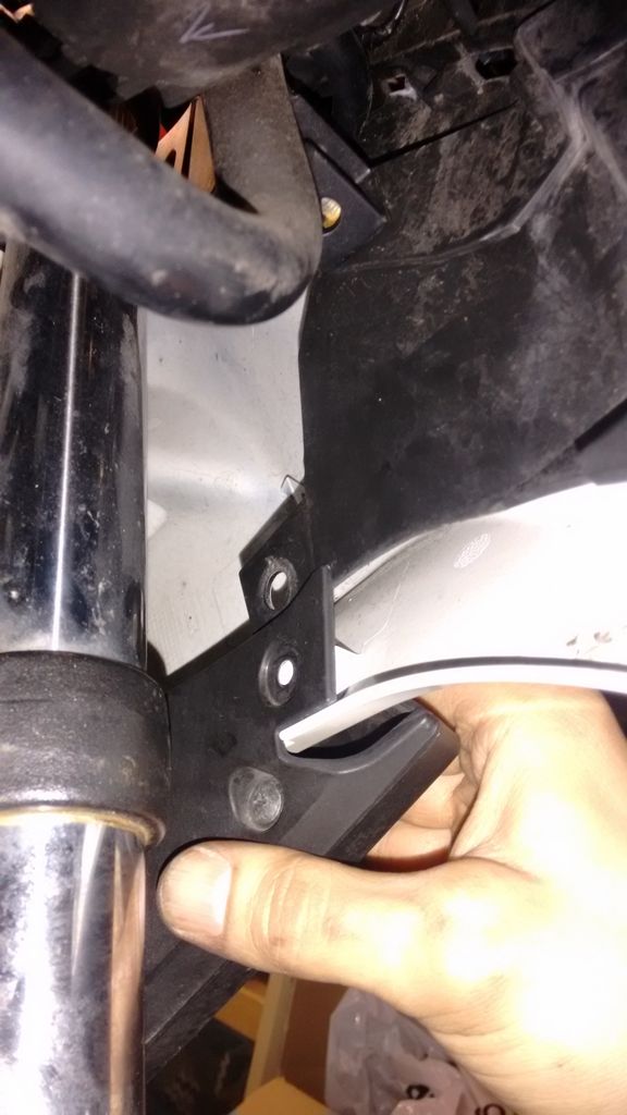

Location of plastic Phillips screw fastener on inside front of the panel
Pull the panel away from the bike at the rear to release the velcro patch and then pull forwards to release plastic lugs from slots in the centre fairing panel. Slots on centre panel:
Lugs on inside of fairing side panel (front pointing down):

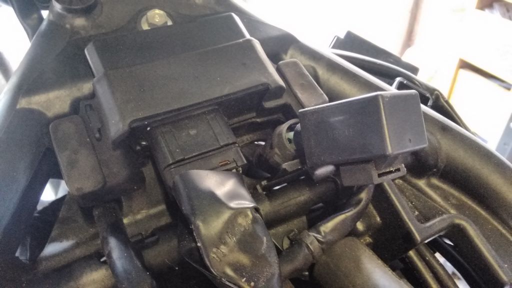

Remove Hazard Relay and ECU
The ECU and Hazard Relay are located just behind the headstock on the under-tank tray. Pull the Hazard Relay up off its mount and release the electrical connector in the base. Remove the Relay and push the connector back through the under-tray.
Disconnect the multiplug from the base of the ECU and remove the ECU by pulling it forwards and up through the rubber mounting band.

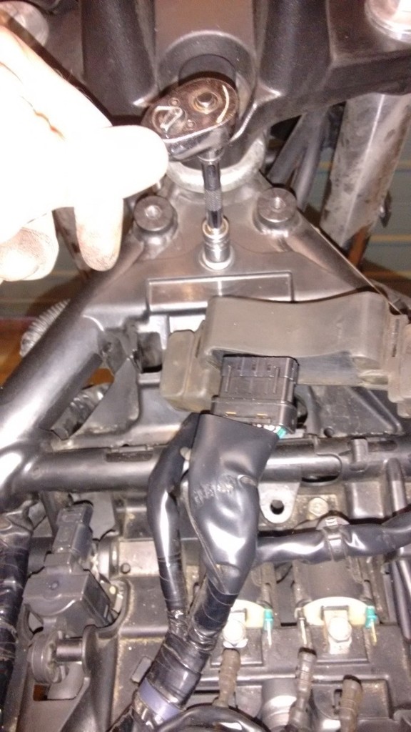

Remove the 10mm nut and bolt securing the PAIR valve to the under-tank tray
and slide off the spigot, so that it is no longer attached to the tray
Carefully lever the clutch and throttle cables out of the retaining clip on the right side of the tray
Unclip the electrical connector secured to the outside left of the tray

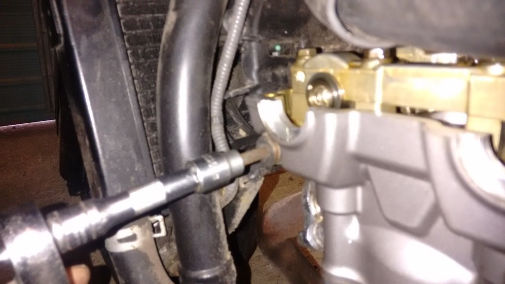

Remove the 10mm bolt securing the front of the tray to the frame
Carefully lift and manoeuvre the tray up and out of the frame. Release the right side first and pull off the plug caps to allow the caps and leads to come away with the tray.
Then lift the front of the tray up and manoeuvre the tray away from the wiring on the left side, taking care not to damage the connector mounting clips

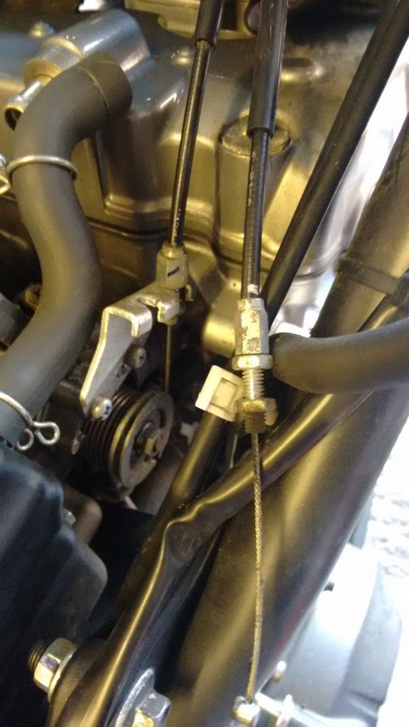

Disconnect Throttle and Clutch cables
To keep the throttle free-play, loosen the locknut on the rear throttle cable and count the number of turns up to the top of the adjuster. Make a not of this for use in reassembly. Unscrew the adjuster to release the cable from the bracket and then free the cable from teh throttle pulley
Unscrew the front cable to release this too

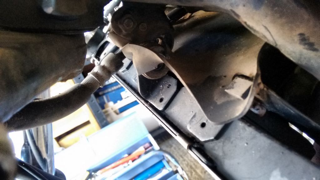

Remove the rubber heat shield
The heat shield stretches from the radiator at the front back to the frame above the cam cover. It is installed under the top radiator hose, so can only be swiveled out of the way to the right. To do this, unloop the ends of the shield from around the frame. Next remove the radiator top mounting bolt (10mm) and pivot the radiator forwards enough for the shield to be stretched over the top of the mount:
Release the shield from the left and right radiator lugs to enable it to be swivelled out to the right side of the bike.

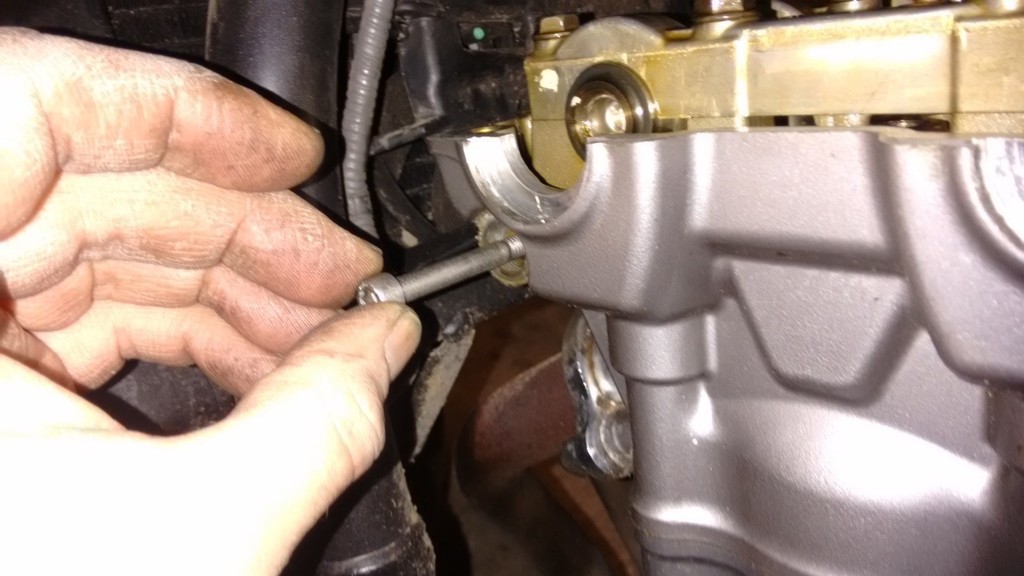

If the gap needs adjusting, then it is necessary to remove the rocker shaft so that the shims can be removed and measured. Unscrew the 6mm allen retaining bolt from the left of the engine
and screw an M6 bolt a few turns into the end of the rocker shaft
Pull the rocker shaft out of the head to release the rocker arms.
