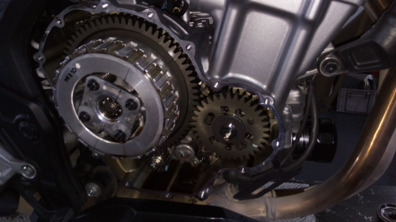

- Remove the clutch cover. The reason is the little spring located on clutch lifter arm inside the rigth engine cover. This spring creates a force on a clutch lifter arm and can makes the hydraulic actuator to doesn't adjust the freeplay properly. So you need to remove it. Sylicone gasket can make the process bit tricky so be carefull and don't damage the cover.
- With the cover separated extract the clutch lifter arm and remove the spring. Insert in its original place the lifter arm without the spring (the spring you can see on a foto is what you need to remove).
- Clean the old sylicone gasket from the cover gasket surface and the crankcase. Use a proper high temperature sylicone gasket for the sealing.

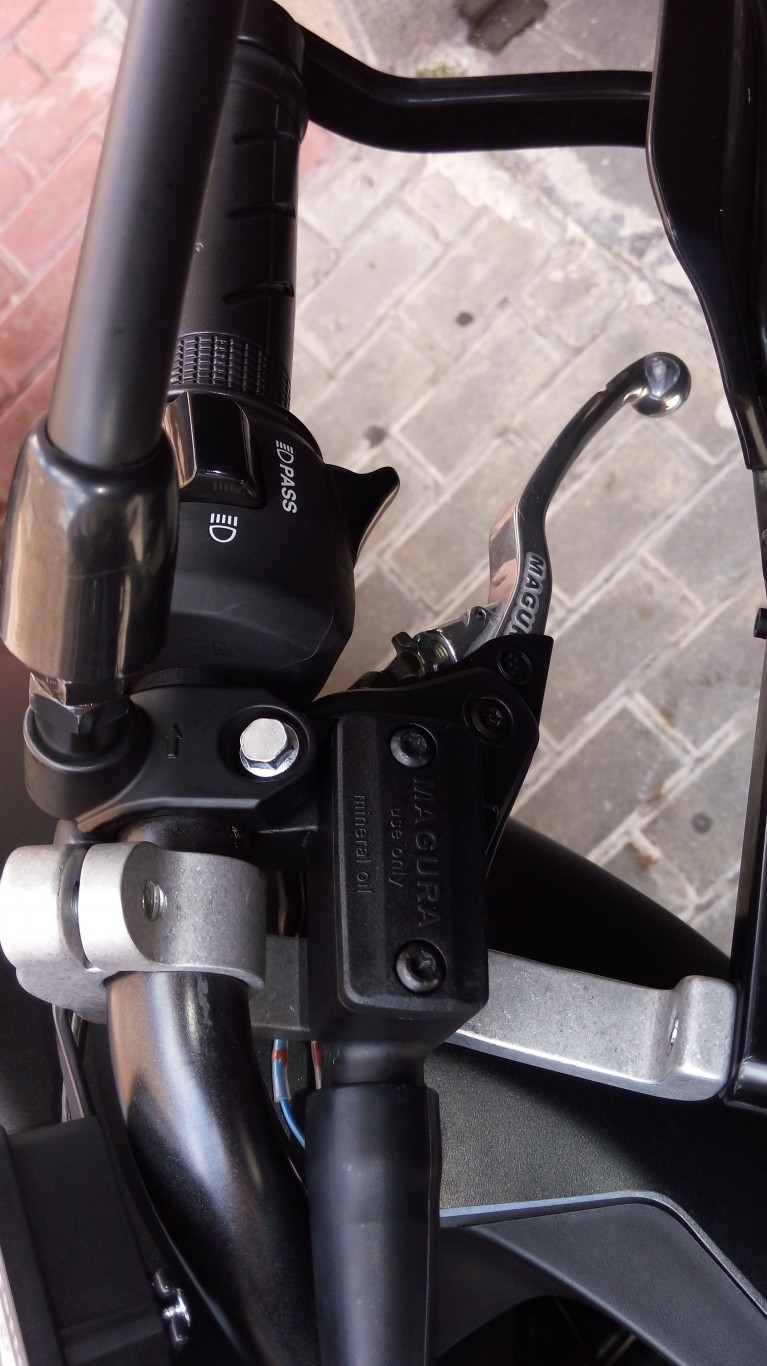

The rest of the operation is quite straightforward - remove the clutch lever support and extract the clutch cable from under the gas tank. It should go out without problems. In my case the Hymec kit was preassembled and filled from fabric so there was no need to filling or bleeding. Just need to guide the cable under the fairing and insert the actuator in the cluth cable holder and mount the master clyinder on handlebar.

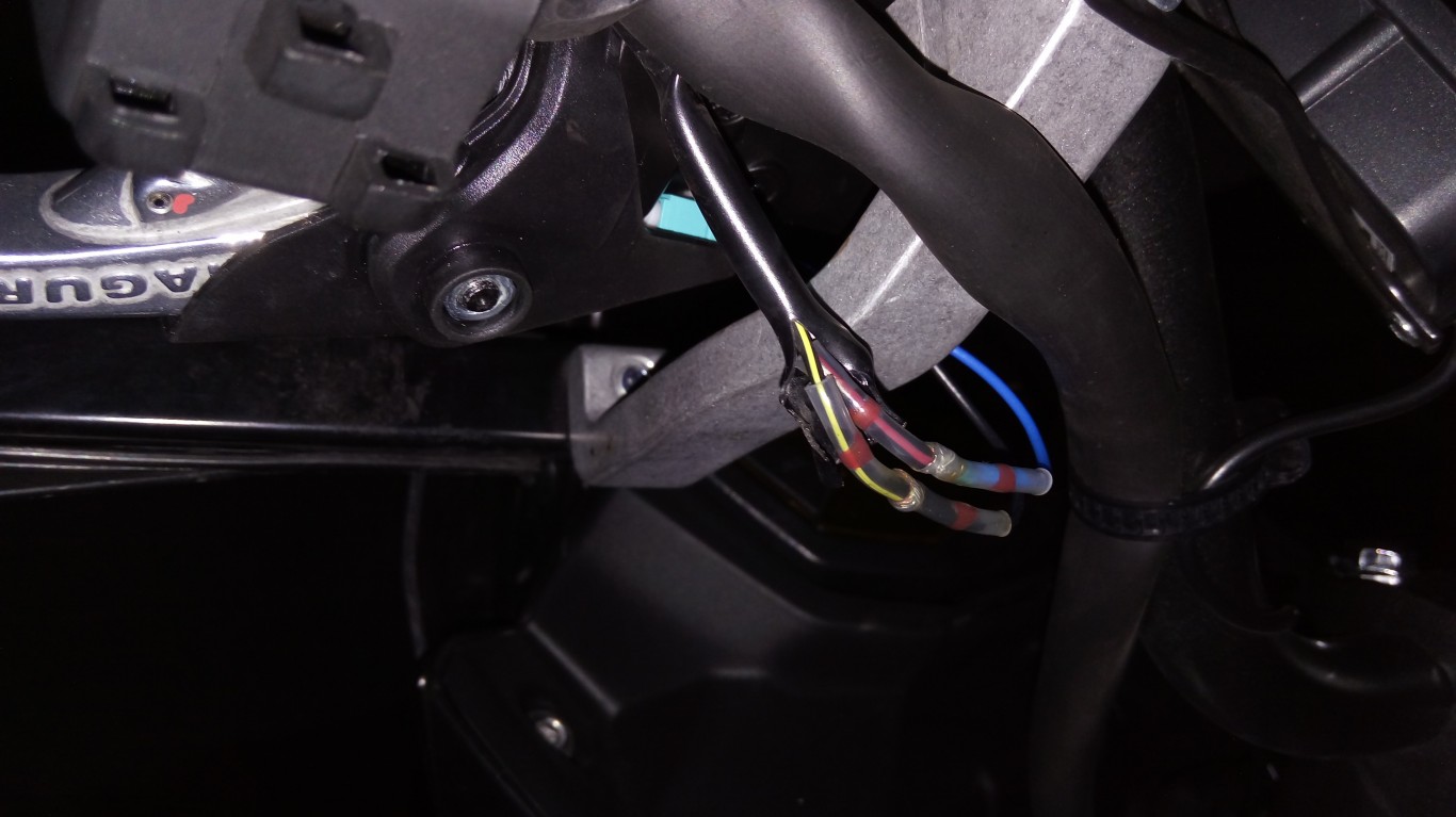

- Magura cames with a clutch switch but the connector is not the same that the CB500X ones. So the connection should be made - in my case I welded the cables without connectors. You can use the welding or to search for a proper waterproof connector.

And here is the result:
