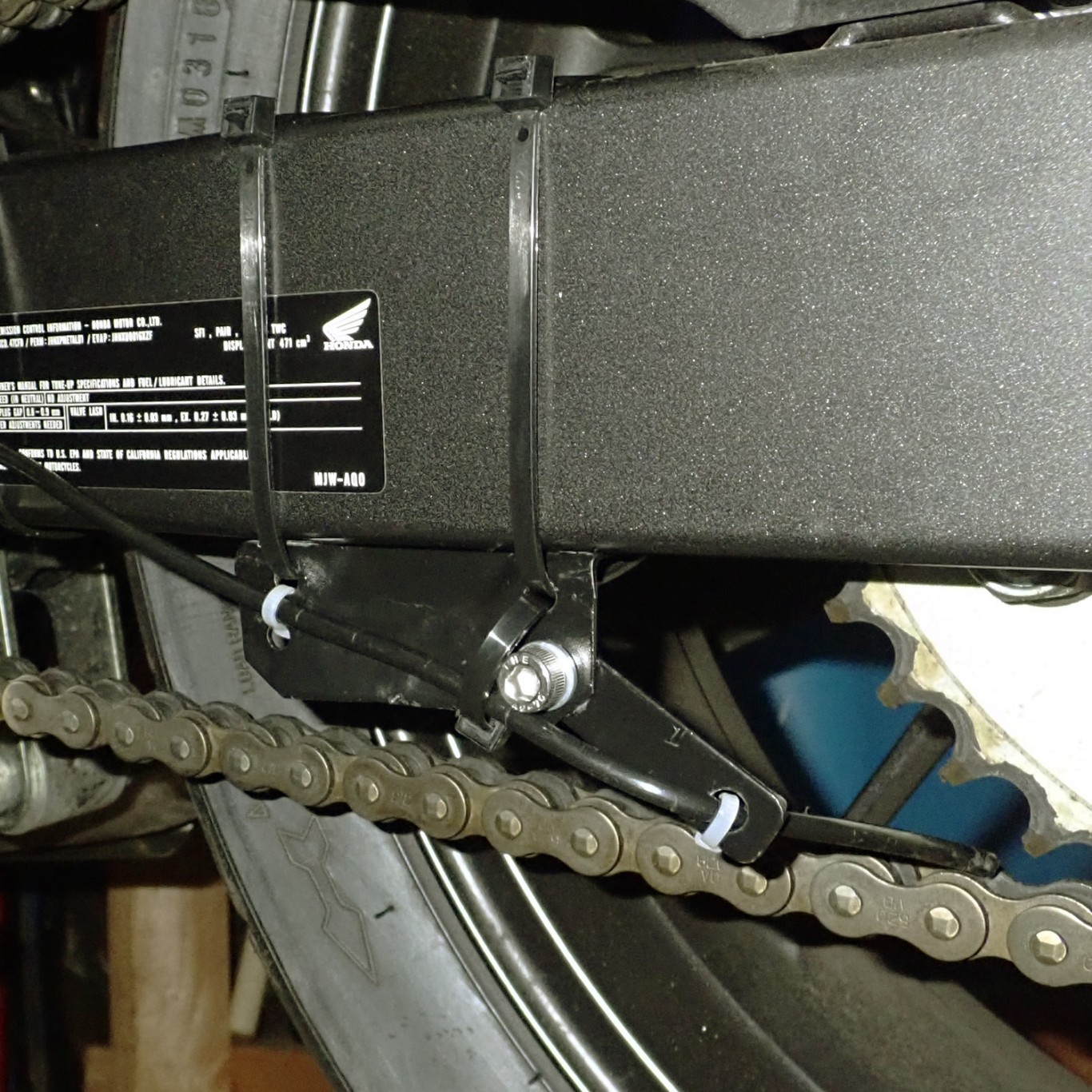

I finished up my replacement bodge for the chain oiler drippy thing tonight, I think it may just work out.

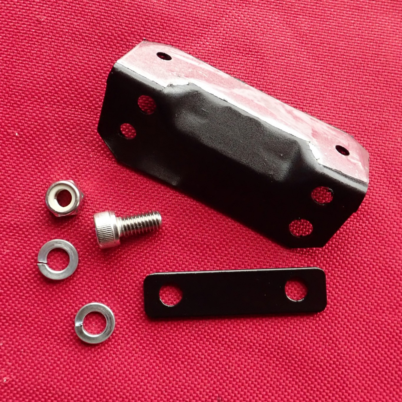

I found a bracket at the local hardware store's building section, the nut in the picture was replaced with a Nylock that I found in my box of misfit tools.
I then drilled two more holes and enlarged the bolt hole - conveniently, the bolt is a 5mm allen and the nut is a 10mm wrench
Making sure everything fits but, at this stage, the drippything looks too much like it came from the Touratech parts bin
A lick o' paint hides a lot of sins
An old tube of gasket maker that keeps on giving
Installed, and stuck on with gasket maker. But zip-ties are my friend.
The easy to remove side panel reveals the threaded tube on the bike's frame
And the tube is under the swingarm. I prefer Bullroarer's idea of getting some proper clips.

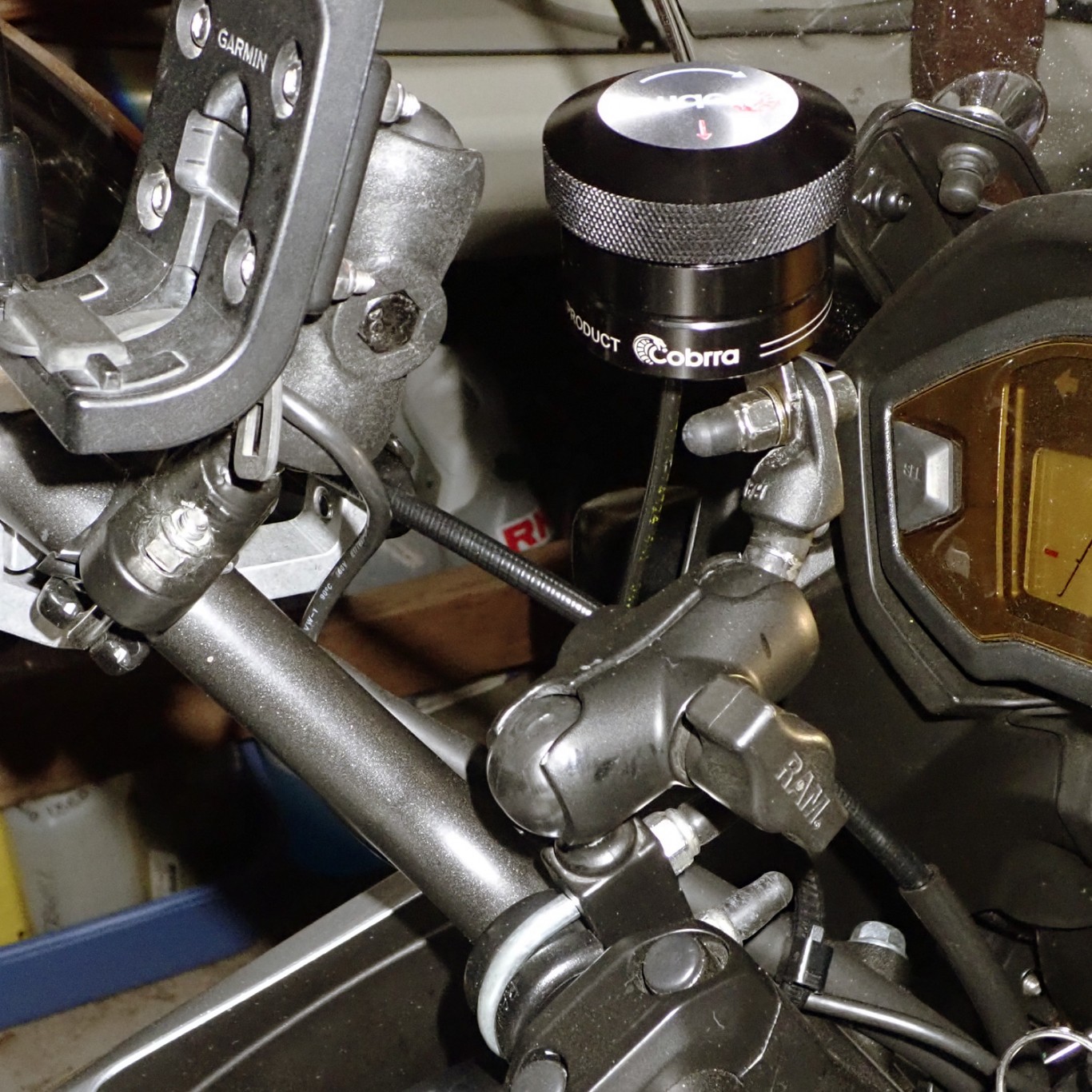

Over the years, my collection of RAM mounts, arms and balls has grown to the point where I can spare some for the Cobrra's master cylinder. This fits quite well behind my Garmin GPS mount, but I'll see how this setup works, and may try something else if it's too awkward.
