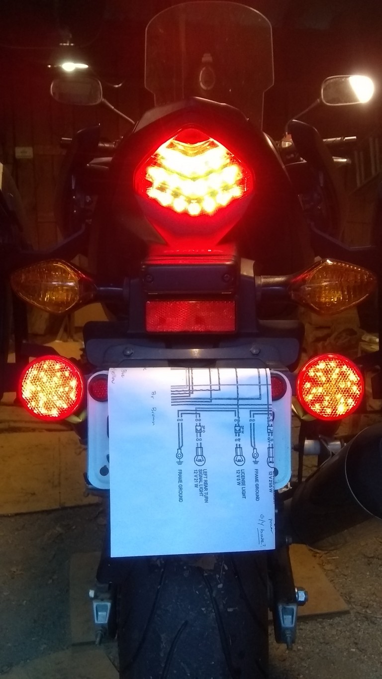

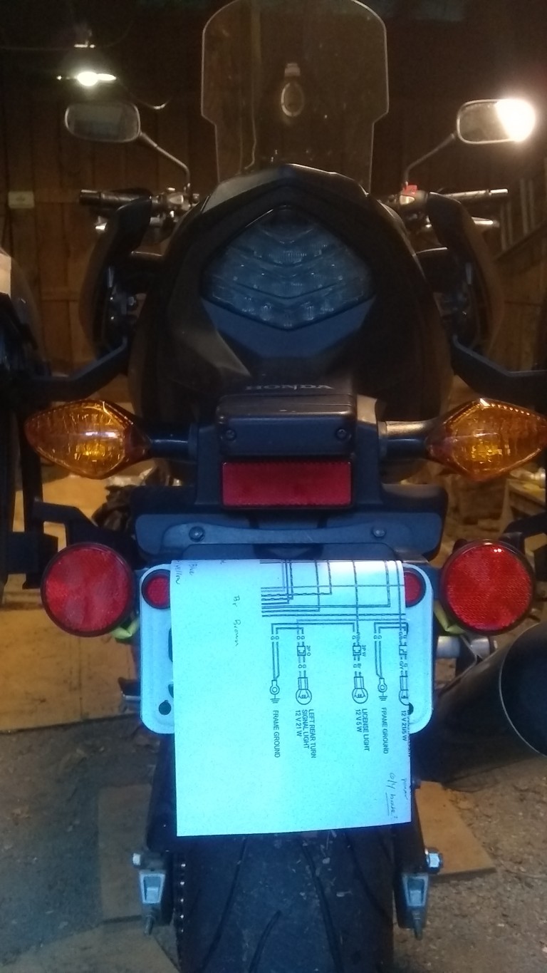

After *almost* being rear ended during a rain storm by a SUV driver on her phone ("oh, sorry, I didn't see you!!!"), I added two round LED lights to the back of the bike. These are three wire red LED lights (pretty inexpensive on Ebay).

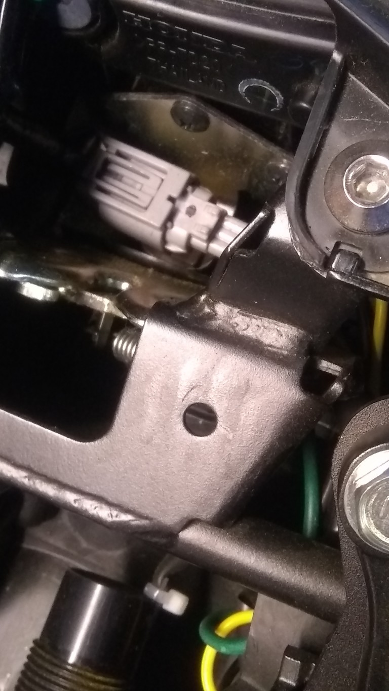

The black wire is ground, the blue running, and the pink(ish) stop . I tapped into the grey taillight connector under the seat, just behind the seat latch, and connected everything up pretty easily.

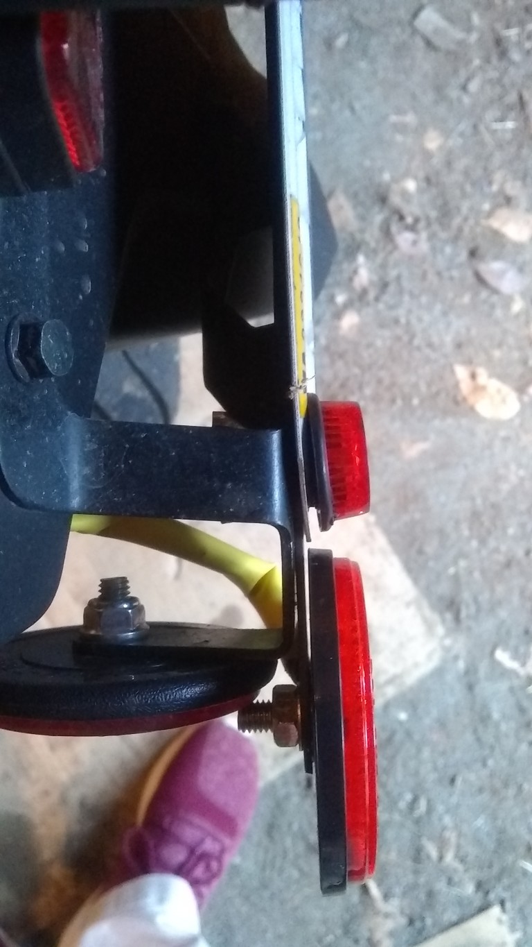

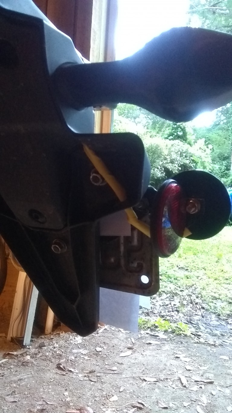

I ran the three wires from each LED light through a heat shrink sleeve for protection, although I didn't heat shrink it. The sleeve runs through a drilled hole in the rear "fender", then up into the space behind the rear fender inner cover, which is held on by three bolts. There's kind of a drainage slot that the heat shrink sleeve goes through. Almost like it was designed that way.
The LED lights are attached to a black painted 1/2 inch aluminum strip that I sandwiched between the license plate and the license plate holder.
The running lights look really good at night, and I like the two extra stop lights for any hour.
