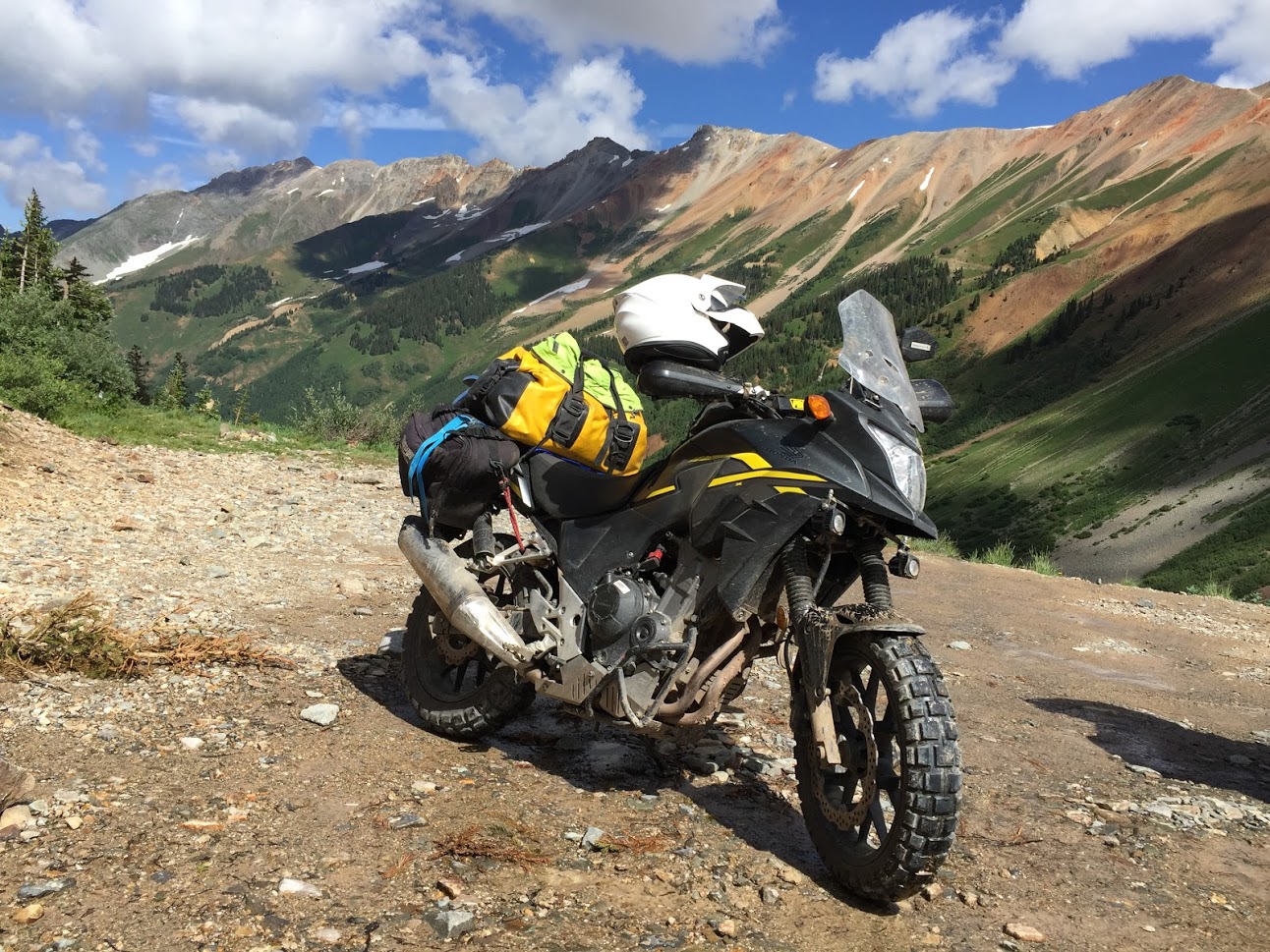

A couple of days after installing the 2019 springs, dampers, and a cheap set preload caps, I set out on a 3K+ mile trip which included the Colorado BDR.
https://ridebdr.com/cobdr/
I must say that I was really impressed with how the suspension performed both on road and off. With the 2015 suspension, I always found myself bracing for the impact anytime I encountered a bump, rock, or obstacle in the road. But with the 2019 components, the suspension soaked up everything I threw at it. I recall plowing threw a set of baby heads on one pass almost like I was riding my enduro or mx bike.
In summary, I spent a little less than $100 US upgrading the suspension on my CB500X (front: springs, dampers, prelaod caps, oil; rear: GSXR750 shock). The best money I have spent in a long time on a bike. Before upgrading to the RR components, I would spend the $100 first to see if this meets your needs. If not, no harm. As I'm sure someone would gladly take a full suspension upgrade off your hands for less than $100  :002:.
