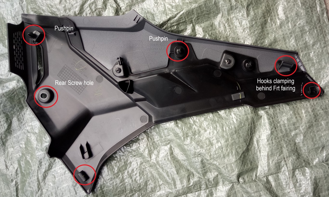

You will find the accessory plug sealed with dummy plug once you have removed RR & FRT LH Fairing. Hope this helps.
I used a USB socket with voltmeter and switch.
The original socket from Honda comes as a cigarette lighter socket type so a USB adapter will be required in addition. Price  is three times the socket I used.
Note: No need to install separate cable back to the the battery as some riders did.
A instruction from youtuber Fred Olsen to disassemble the fairings can be watched here
feature=share.
