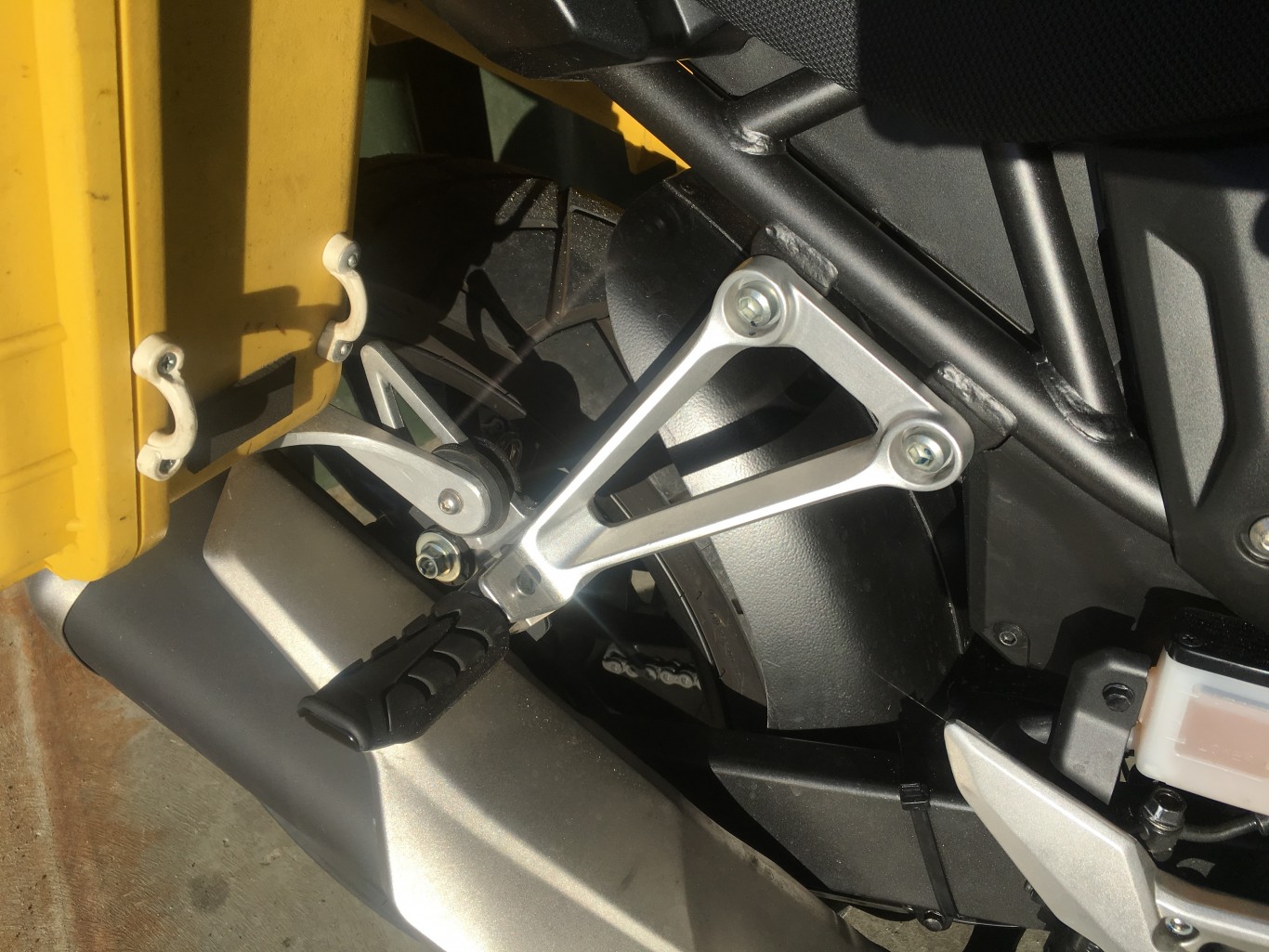

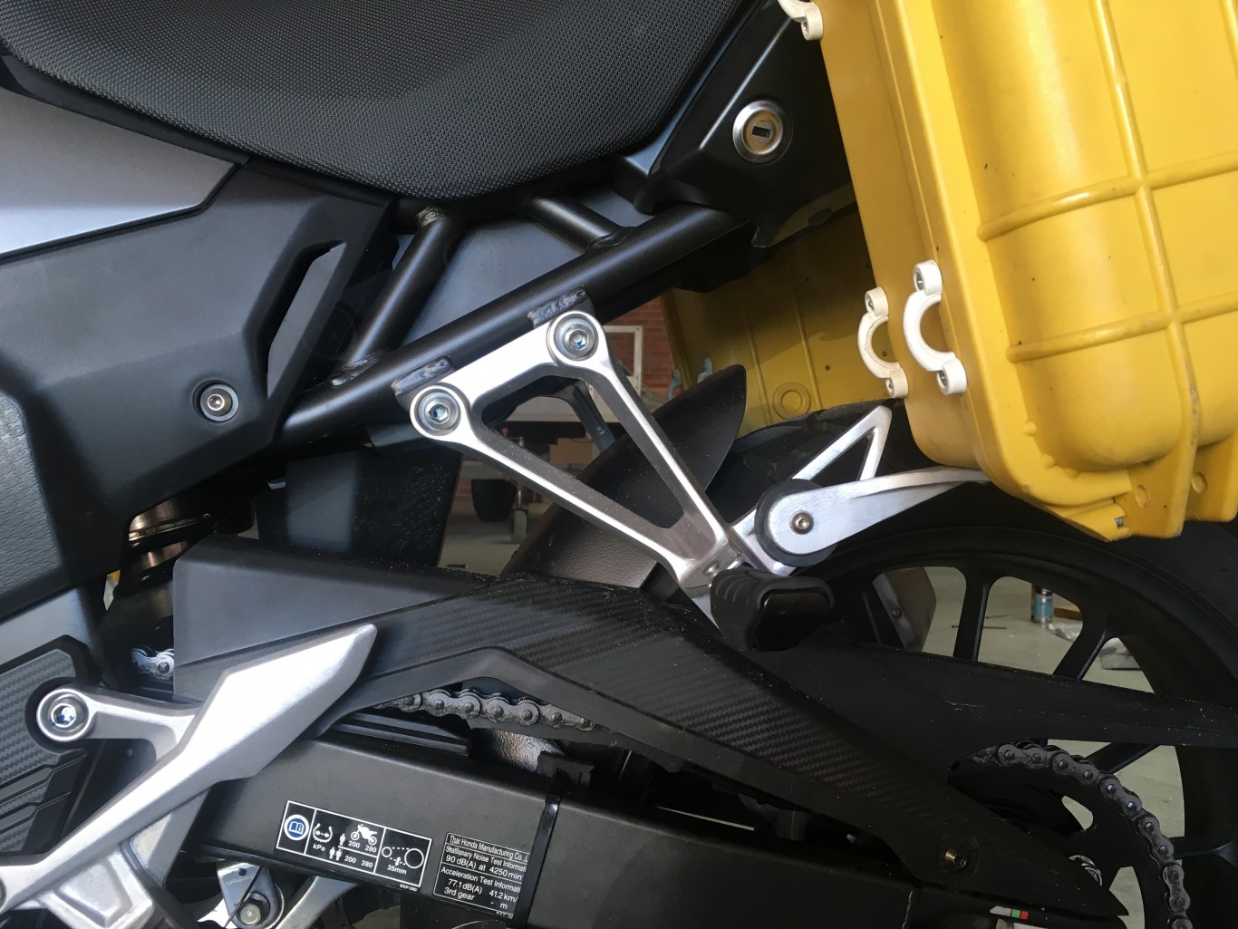

It is possible to do a home made job if you can find an old SUV wheel cover, cut out L & R halves and stick them together.  I made mine to extend below the swing arm to fit between the tire and chain to keep dirt off the chain. The original chain cover  is retained.  The hugger is attached to the swing arm with cable ties and adhesive rubber strip, and is still in place after 5000 km rough riding.
For a front fender extender, you can cut a suitable shape from 1/8" insertion rubber sheet and fix it with double sided tape. Again, still on after 5000 km.  Total cost just a couple of bucks, and a fun day in the workshop away from wife.

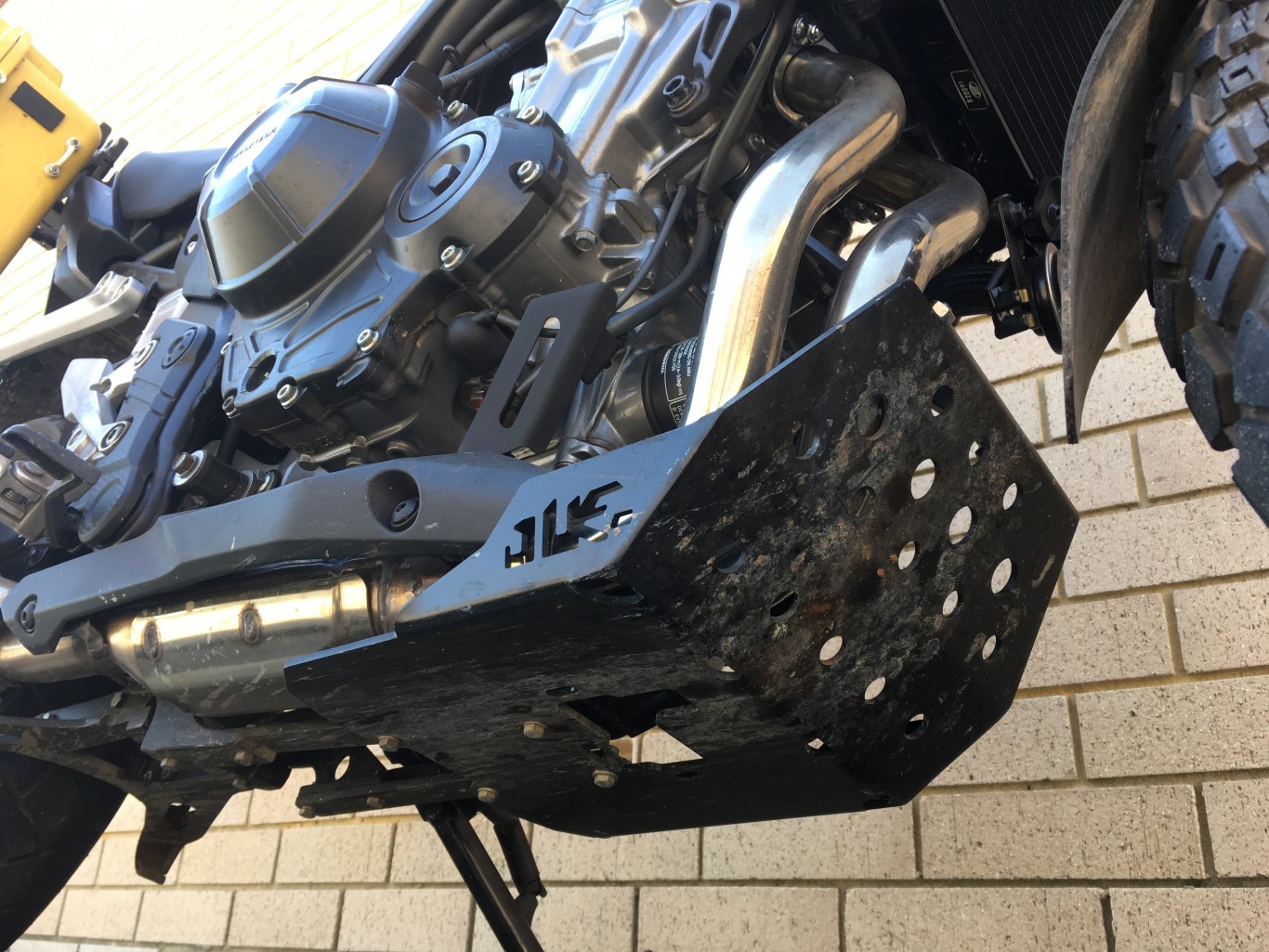

Can I ask what kind of skidplate that is and if you like it?
It is off my previous bike, KTM 390 duke, and originally cost~$100 on aliexpress. It is intended for light duty only; slow speed scrub bashing on overgrown tracks. However, fitting was not easy as there are no handy mounting points on the frame of the cb500x.
I like it because it cost almost nothing and gave me a challenging workshop project for a few days.
