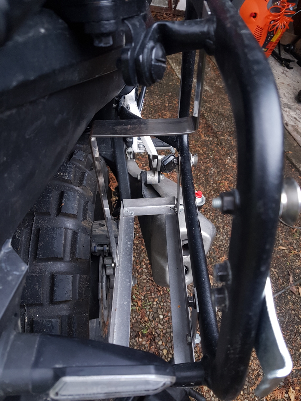

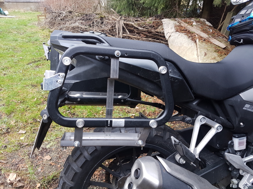

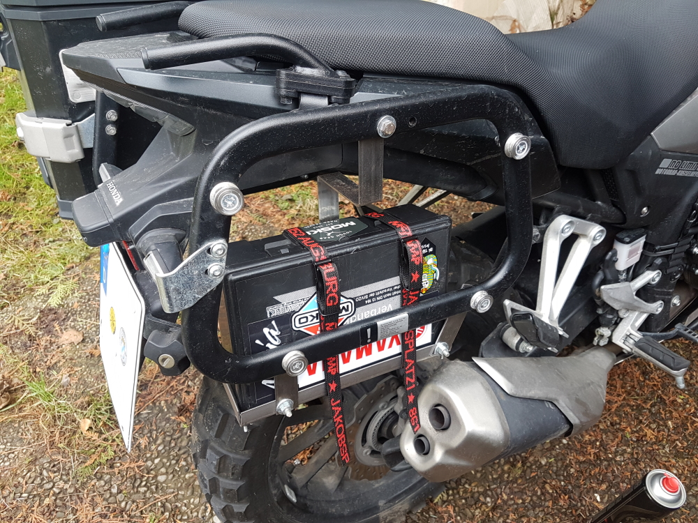

I was always unstatisfied about the space you waste on the inside of my SW Motech EVO side carrier.
To adress this problem I built a prototype of a tool box mounting on the inside of the side carrier. As tool box I used an old first aid box you have to carry around in cars here in Germany.
The frame for this is made out of steel and currently only screwed together (=prototype version). The final carrier will be welded and also painted to protect it from rust.
The box can only be taken out through the SW Motech EVO side carrier. This way it can't be accessed with the side panniers mounted and locked.
--> Anti-theft protection  :121:
Maybe you want to build something like this as well. I will keep you updated on my progress on the final version of the tool box side carrier.
